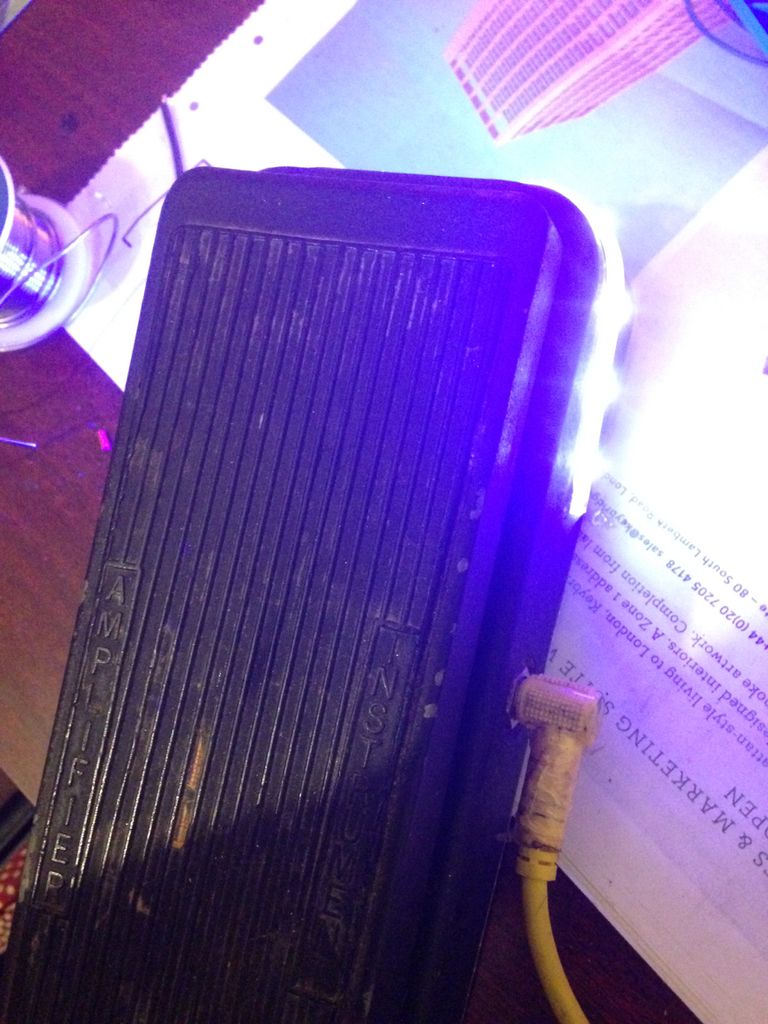

True-bypassed wah and added a futuristic LED strip because it was easier and more fun than drilling a hole for a normal LED

timdrage wrote:True-bypassed wah and added a futuristic LED strip because it was easier and more fun than drilling a hole for a normal LED
Does it dim when you work the pedal?

Post by timdrage » Thu Nov 26, 2015 11:17 am
Ha no it just indicates that the effect is on, that would be great but I doubt it'd be easy to find a double pot that'd fit in there :)

Post by Misomusist » Thu Nov 26, 2015 12:06 pm
Be doable with a Morley.

take the output from the pot on expression pedal as the pos input on the led side of the vactrol. If it's not strong enough to power the led then it'll need a opamp

Tim was right, you'd need a double pot, the signal thru the pot would be dependent on the source signal, and would be AC, the vactrol would act slightly like a clipping diode, but it would need a buffer, with an op-amp and some other stuff you might be able to get the LED to dance to the signal, but it wouldn't really indicate the wah was being used.
Morley's use optoelectronics for their wah, so you could fit another LDR into the light source, and use it to control the LED's.

That'd be convenient but I still don't think it's necessary. I also wasn't suggesting that the lights would dance in time with the audio.. just dim when you work the pedal.
At any rate .. it were necessary instead of trying to find a double pot that fit.. I'd mount a second pot and 3d print a gear for it that could be driven by the existing mechanism.

It's not actually mine, and It's a Dunlop crybaby of some kind

I think there's space behind it for a double pot, i think there's just a fork in the casting the pot is clamped to by the shaft, and that's it, nothing behind it, so there might be space.
